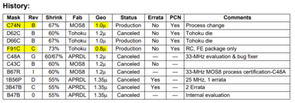

Because mine is the socketed variety, I purchased a 50 MHz 68882 coprocessor from a different seller, along with two 50 MHz rated 68030 chips. I swapped the 40 MHz chip with mask 09C74N from 1992 for a 50 MHz with mask 1F91C from 1999.

I swapped the 33 MHz rated 68040 with 02E31F mask for a newer 02E42K mask with a 40 MHz factory rating. Both were manufactured with a 0.65μm process. I do not have anything better, such as a K63H or L88M at 0.57μm.
