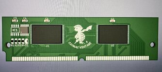

This is in production now in China :), will arrive next week, then I need to run some testing and send out a few beta units.
The simm will automatically switch some pins between se/30 and “Quadra”. It’s 4MB because this is the maximum you can use with the apple flasher tool (as per @dougg3 findings). So this ROM simm will work in anything from a SE/30 to Quadra 840AV. Of course with different images! It’s also compatible with @dougg3 s programmer and all derivatives (@WillJac and @bigmessowires ).
The idea that this SIMM can be used in conjunction with a hacked flasher tool that @dougg3 is working on :).
As for ROM hacking, that’s for whole other thread 🧵 😄
That needs an 822033-2 or a PE HWS1788-equivalent socket, right? Getting my socket order in now 😛
