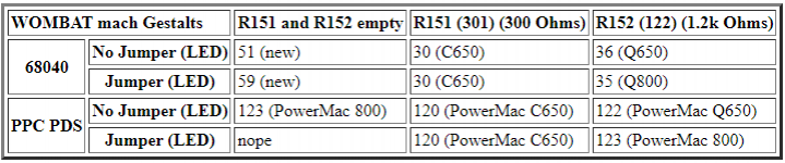

Wombat (650, 800) board overclocking limitations
