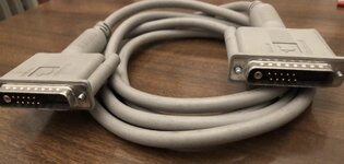

Um, what cable is this?
TimHD
Any ideas what this might be for. Was thinking an Apple Monitor ie a monochrome display (as it has those pins on the 13w3 displays) but usually those cables have the Monitor icons on them, not the Apple icons, so possibly not…IMG_1155.jpeg
How strange. Can't seem to find anything. Not related to the DB13W3 it seems, but searches for "Apple dsub coax high frequency" and similar turns up nothing for me...
yeah that figures when you realize that the three thick pins (or "stubs"?) are for colours so omit extras and you have a cable that basically is black-or-white choice of colour all alone or in this case black-or-green
Yep that's for the Portrait Display connecting to the Portrait Display NuBus card - there is also a version that has a DA-15 connector in one end. It's a bit more flexible and easier to deal with than the tripple coax version!
@MBongo I think this one is intended for the dual page display, but it will definitely work with the Portrait Display. I have one exactly like this and have used it with my Portrait Display, just means there's two extra coaxes on the left there that don't connect to anything on the Portrait Display.
