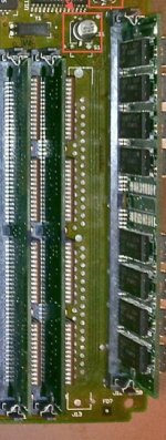

I have a feeling we'll find that out very soon, I just looked at my Microquadra MoBos and one of the Q605 pair has the ROM SIMM thru-holes populated! 8-o
So, despite my snark, cleaning the solder out of the thru-holes and installing a SIMM Socket in your 475 can be considered a factory option package refit.

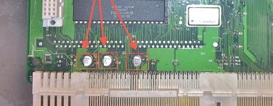

As jt said, (unless your 475 is different) There is Rom Simm spot on the mainboard pcb, but the actual rom simm slot is missing.
unless you have a special LB, OOM.
Also yes it would require much more modification, The q700 also has a Rom Simm Slot. but this kind of info would be much better in the original ( engineering thread, if you are trying to motivate the one that have the abilities to do what you are talking about.

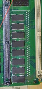

Mcdermd just shot this image of the LC475 LB.
Check the empty(?) pads/thru-holes betwixt VRAM and the soldered RAM. If empty, the only way to use the ROM SIMM is to install the socket where Apple must have decided it wasn't necessary to do so after the early production unit ROMs field tested well.
Now to look at my MoBo for the spot, Apple placed a select/de-select option for the ROM SIMM on this (assumedly) early production unit. :approve:
The header at J18 is for 605/475 Gestalt ID selection, correct?
edit: beat me again, uni!
p.s. Does anyone else have a 605/475/AIO equivalent with the factory installed ROM SIMM Socket?
I don't know of a ROM Simm Enable jumper LC475/Q605, such as on the IIcx,IIci,IIsi.
However I am sure there is a way, even if its a 000 Ohm resister somewhere, VS a jumper, I could live with that!
