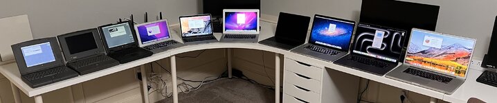

And now, "all integer inch size screens", 8-17: (Yeah, have to truncate sizes, not round, to get that.)
(The 14" is powered off because it's my work laptop and I'm off work this week.) Kind of interesting that the 13" MacBook Air is in the center of the picture, when it's also exactly at the center, age-wise. (16 years between PowerBook 100 and MacBook Air, 16 years between MacBook Air and 14" MacBook Pro.)
I enjoy that the three plastic "sub notebooks" are thicker than the *SEVEN* Aluminum laptops, including *FOUR* "full power" models.
Heck, the three Aluminum sub notebooks combined are thinner than just the Duo!
