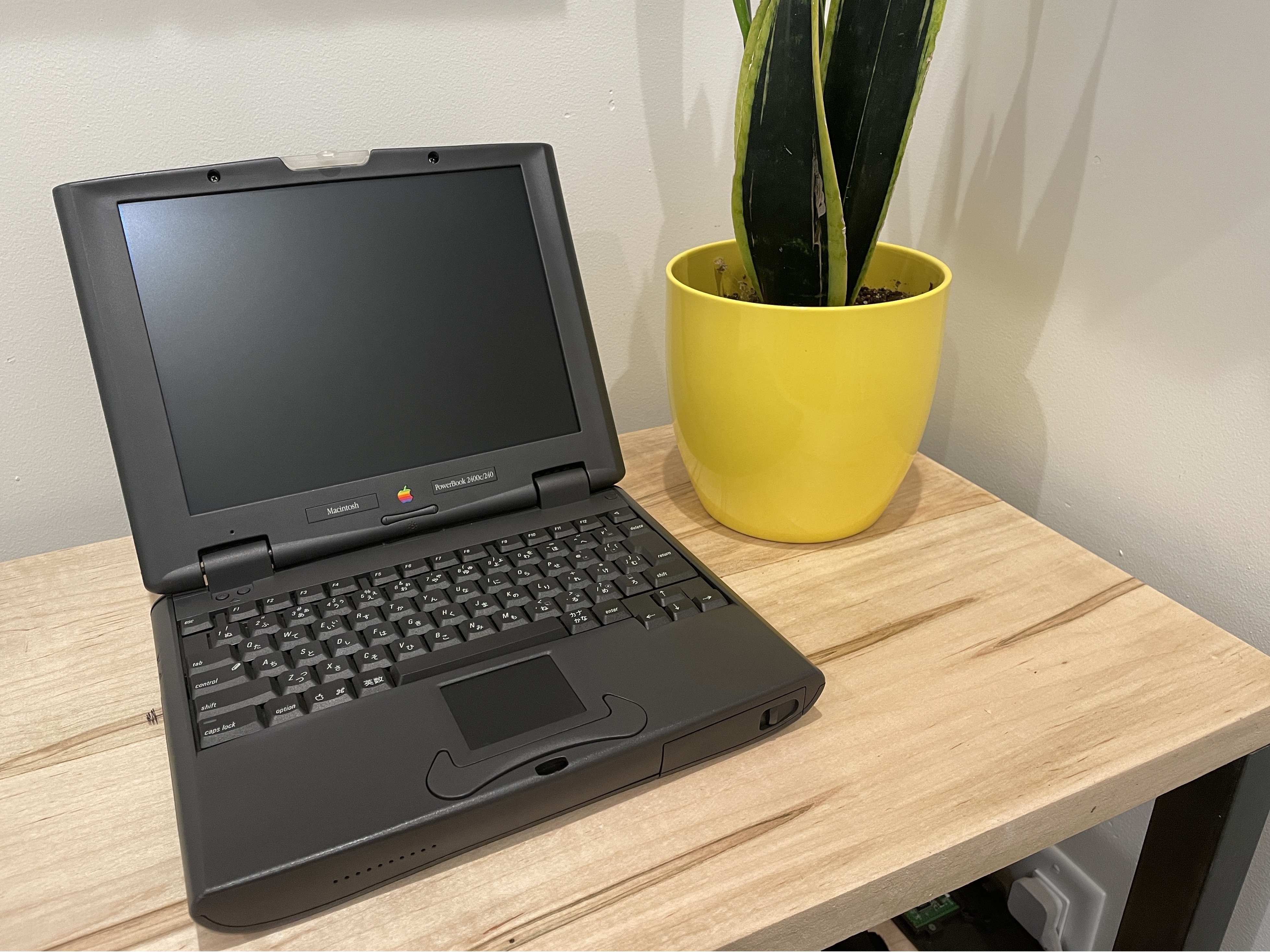

Hi,
I own and love using 2 x PowerBook 2400c - one a stock 180Mhz model, the other a 240Mhz G3 Newertech unit. Both have worked flawlessly for years, both had good batteries, the G3 unit was the oldest where I replaced several SMT fuses when received. The G3 unit started to show issues a year or so ago when the G3 unit's L2 cache failed to be recognised at startup, before slumping into the dreaded "green light of death" coma I couldn't get out of.
The stock 2400c/180 was going well, I tore down both units with hopes to get both working, maybe switching the motherboard and CPUs around. Did so - and now met with GLOD coma on both units, no matter what I try! There is a "fuzt" sound when power is applied before the GLOD comes on after 30 seconds, both units do the same thing.
I was wondering what other people have tried to get out of this funk, more info below:
- All SMT fuses check out, including all those on the DC power board and the ones I replaced years ago - there are a lot
- PRAM batteries were cut out years ago with no corrosion around the connectors, I used these without PRAM batteries for years but thinking I should try to rebuild one NiMH 3.6V to rule out some sort of power manager issue
- I found the G3 motherboard had a tiny area of liquid damage on two SMT capacitors of unknown type, they crumbled off when touched, I repaired using comparable looking capacitors from a faulty IBM Thinkpad, similar era, repaired a small trace. Exact same issue - GLOD!
- Boards have been deep cleaned, connectors checked and inspected under magnification.
- There really aren't any caps to replace, the power board uses sealed (purple) organic caps which reportedly are good to stay
- I've left them plugged in for a few hours to charge the batteries, the units are warm as per normal use during this.
Any clues - thank you!

Hi all,
I've had partial success with my 2400c units - the stock 180Mhz unit is now working 100% reliably (with the repaired motherboard and SD to IDE adapter) while the 240Mhz G3 equipped unit worked for a while - before going back into GLOD city.
Some things to note:
- Whoever wrote this guide and documented screw dimensions needs a medal - the 2400c can be taken apart completely in a few minutes when you know what screws go where.
- The GLOD 180Mhz unit came to life after a deep clean of the CPU connector using Deoxit and repairing two of the brass standoffs in the internal frame, I noticed two brass mounts were loose in broken plastic and when threaded down slightly skewed the frame and CPU placement, possibly causing connection issues. Both mounts were repaired with JB Weld and had to find a slightly longer screw (the brass one) in one mount to grab the other mount. The thermal pad was also replaced on the bottom shell with a thicker pad.
- The GLOD G3 unit also chimed and booted on the bench but gingerly putting it back in the casing, screwing everything down it would alternate between chime/GLOD. I did get it fully assembled, and booting and was able to install Mac OS 9, however the OS displayed a "the onboard cache has detected an issue" warning during every boot. The next day it wouldn't turn on at all. More tearing down, I tried spacers between the double CPU edge connectors (to rule out flexing/wear), inspected the G3 and cache and applied pressure on certain areas but couldn't get a reliable boot. It's back together and I'll look for another CPU soon.
- These cheap SD to IDE adapters work well on the 2400c (had some spare they do not work in a TAM).
- The mouse clicker was awful on both, you can take it apart three screws, slide out the trackpad off the ribbon and lift the entire unit out. Pop off the mouse button and you'll see two foam pads, both will be perished. I replaced the foam with some door frame foam cut to size, cleaned the buttons with solvent spray, bent back the little long black metal clicker thing, all seems well.
- I confirmed the DC boards, motherboards were working so can assume CPUs going bad in the 2400c is the main cause of GLOD and failure.
JB

Another new day and .... that's all it got to before freezing. Any more effort no chime and GLOD.
its like...almost there.

I've given that G3 240Mhz upgrade a full inspection, freeze sprayed components, tried DIP switches, they were notorious for failures. It might work tomorrow ... or not :)
I picked up the transparent Yu plan keyboards separately some years ago, one came from a 68KMLAer. The G3 one has the 96MB RAM upgrade, purchased years ago when prices were reasonable. The 180Mhz has a 32GB SD card and the G3 128GB SD in the adapter mentioned. They take their time awaking from sleep 5 - 10 seconds but that's fine they don't have any other issues like when I tried in my TAM (data corruption, boot delays etc).
Updating my travels, picked up a "worked last time" 180Mhz stock CPU to replace the G3 in my better 2400c, and it did work for me, but note "last time", chiming and happily booting an perfectly working on desktop, cue another restart, GLOD never booting again :)
The motherboard on this one is absolutely pristine unlike the other board that needed some surface level repairs. I'm tempted to try all the "worked last time" 180Mhz CPU on the working 2400c, however noting the difficulty there am a bit wary of pulling it apart again.
Might have to find a parts unit or one with a broken screen that chimes.
Think so keep the good one intact and only go near the dicey one when I've a friend.
