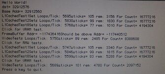

OK, I've written the test application. It's not very big. Source code and application are included. The results take a bit of interpreting.
My PB1400c is a 603e Mac (as we all know). So, it has a 4-way x 16kB, Write-back L1 Cache. It also has a 128kB L2, Write-Through cache. So, I need to test up to "8 sets" in my test to force a flush to L2 (which also forces a flush to what's called the I/O bus on the PB5300/PB1400, which is kinda equivalent to the '040 bus on the 6200). Hence my version of the application is different to the one for the P5200/6200.
Mine's also written in CW11 Gold, I don't know how easily that converts to the later versions people tend to use. Here are my results and my interpretation of them:
TestTicks/LoopTicksRemCountBandwidth (MB/s)
1Set1298489357871134217728134217728*4/1048576/((93+(129848-57871)/129848)/60)=328MB/s
2Sets129738969139134217728134217728*4/1048576/((96+(129738-9139)/129738)/60)=317MB/s
4Sets1294219895702134217728134217728*4/1048576/((98+(129421-95702)/129421)/60)=313MB/s
8Sets129780627776120971522097152*4/1048576/((62+(129780-77761)/129780)/60)=7.69MB/s
So, what we see here is a demonstration of how great L1 cache is and the dramatic difference between L1 cache memory and the main I/O bus on a PB1400C. But are the L1 cache values realistic? Well, the PB1400c runs at 166MHz. 328MB represents 82M x 32-bit writes/s, equivalent to about 2 cycles per store instruction, which is probably correct. It also looks like there's a slight penalty for accessing different sets, which is interesting.
And my guess, is that the poor main RAM performance is because the PB1400c's bus is just 32-bits and uses pseudo-static RAM. 7.69MB/s is 1.9M 32-bit bus cycles per second for an average of 520ns per bus cycle. I mean, that's bad huh?
The version supplied will go through up to 8 sets and wait for you to press the mouse button. When you do, it'll check the Valkyrie VRAM test, writing directly, as I believe, to the VRAM addresses beginning at $F9000000. And this could be totally wrong, because for all I know those are its I/O regs so it'd be a major disaster ( @noglin ... are the I/O regs there or the screen memory itself). Perhaps I should just take the address of ScreenBits, then it would also work for my Mac. So, it's probably best to Restart the Mac instead of pressing the mouse button the first time, i.e. don't even press the mouse button once, just perform a physical Restart. The next version will have a real event loop, not a wait for Button()!.
I intend to build and submit a version that should work for the 630 at some point too. Still, this version should be useful for comparing your P6200 with my PB1400.

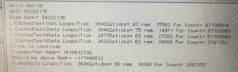

And finally, the 68K version! These are the results I get for that:
For 68K version running on my PB1400, I get slower results.
L13640287155626710886467108864*4/1048576/((87+(36402-15562)/36402)/60)=175MB/s
I've just included the normal L1 calculation, because the other calculations that fit in cache are basically the same. It's pretty good, 175MB/s is 53% of the performance of the PPC version. I didn't optimise for 68020, because on a 68040, 68000 is probably faster and I didn't have an '040 optimisation option.
We can guess what the performance of a 6200 for the 1 and 2 sets tests will be. It ought to be simply be 75/166=148MBs, a bit slower than my 68K emulated version! The VRAM test did actually affect my screen, so I think it was a correct mapping! And it ought to be uncached too, because it's using the actual VRAM addresses.

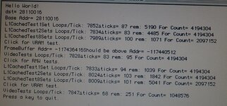

I've updated the tests to include RMW tests, which operate on whole words to add the current loop countdown to a given word. I think that's as valid as operating on bytes. I removed the 4 Sets test because a 603 and 603e will both flush L1 cache lines in the same way for an 8 Sets test. Here are my new PPC results:
TestLoops/TickTicksRemCountBandwidth (MB/s)
1Set1196609364898134217728134217728*4/1048576/((93+(119660-64898)/119660)/60)=328MB/s
2Sets1238899627947134217728134217728*4/1048576/((96+(123889-27947)/123889)/60)=317MB/s
8Sets12368362912402097152134217728*4/1048576/((62+(123683-91240)/123683)/60)=313MB/s
VRAM123997603978520971522097152*4/1048576/((60+(129780-39785)/129780)/60)=7.69MB/s
1SetRmw1240237144616710886467108864*4/1048576/((71+(124023-4461)/124023)/60)=213MB/s
2SetsRmw123541101953896710886467108864*4/1048576/((101+(123541-95389)/123541)/60)=151MB/s
8SetsRmw124028629020620971522097152*4/1048576/((63+(124028-90206)/124028)/60)=7.59MB/s
VRAM1240086466410485761048576*4/1048576/((64+(124008-664)/124008)/60)=3.69MB/s
And here are the results compiled for the 68K version.
1Set3587688200236710886467108864*4/1048576/((88+(35876-20023)/35876)/60)=174MB/s
2Sets3593075353556710886467108864*4/1048576/((75+(35930-35355)/35930)/60)=205MB/s
8Sets35888622793720971522097152*4/1048576/((62+(35888-27937)/35888)/60)=7.71MB/s
VRAM35907601191120971522097152*4/1048576/((60+(35907-11911)/35907)/60)=7.91MB/s
1SetRmw3592069206823355443233554432*4/1048576/((68+(35920-20682)/35920)/60)=112MB/s
2SetsRmw3546472180353355443233554432*4/1048576/((72+(35464-18035)/35464)/60)=106MB/s
8SetsRmw35738622797120971522097152*4/1048576/((62+(35738-27971)/35738)/60)=7.71MB/s
VRAM3591464174710485761048576*4/1048576/((64+(35914-1747)/35914)/60)=3.70MB/s
As we can see, RMW performance in most cases (apart from 8Sets) is about half the speed of simply writing to memory; main memory speeds are shockingly slow; RMW for main memory, oddly enough is the same speed on my system; 68K performance is about half that of native PPC performance (impressive, and implies that the branch unit really has an effect); VRAM RMW is half the speed of VRAM Write, which is what I'd expect from the system diagram, since VRAM simply hangs off the IO bus and is directly accessed rather than going into a graphics chip buffer as you might expect for Valkyrie.

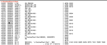

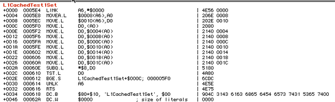

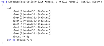

Since you are trying to hammer memory as fast as possible, you should predecrement (--aCount) rather than postdecrement. This eliminates an instruction per write on the 68K.
Postdecrement
Predecrement
In fact, why not really hit it hard by subtracting 8 from the loop variable only once per loop?
Postdecrement
Predecrement
View attachment 95692View attachment 95691
Of course, didn't think of that, though normally I do use --x or ++x for that reason. It's odd though, because surely a sequence like:
move.l regACount,0(a0)
subs.l #1,regACount
move.l regACount,4(a0)
subs.l #1,regACount
move.l regACount,8(a0)
subs.l #1,regACount
could be generated by a reasonable compiler?
Do you have any of these machines: P5200/P6200/P630/Q630?
Yes. I completely agree that is a compiler deficiency, rather than a programmer deficiency. I notice that Metrowerks C library code differs in speed-critical sections when incrementing/decrementing pointers in PPC vs 68K. So, even they were aware that the compiler was suboptimal.

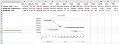

I tested using MacOS 8.1. Same exact drive, chassis, etc for all tests. Only the motherboard was swapped. I did not modify your application. For consistency, I used the compiled versions exactly as you uploaded earlier in this thread.
Quadra 630
Power Macintosh 6200 Emulating the 68K tester. Faster raw loops but worse memory performance.
Power Macintosh 6200 full PPC mode. Much faster raw loops. Mixed results on memory performance.
Now here is my old cache tester program. It prefills a buffer and then just performs main memory reads (no writes) for 1 second and then increments the doubles the read size and loops (256 bytes for 1 second, 512 for 1 second, etc). It shows the Quadra 630 crushing the 6100.
I reran the tests on the 6200 603 @ 75 MHz and got basically the same results. So, I didn't modify the spreadsheet for those rows.
I then ran it on a 6300 603e @ 100 MHz board (same chassis). Dramatically better, but still doesn't beat the 68040 internal cache for this particular test application.
Both Metronome and Apple System Profiler confirm a 256KB L2 cache on both 6200 and 6300 boards. 37.5 MHz vs 40 MHz bus.
