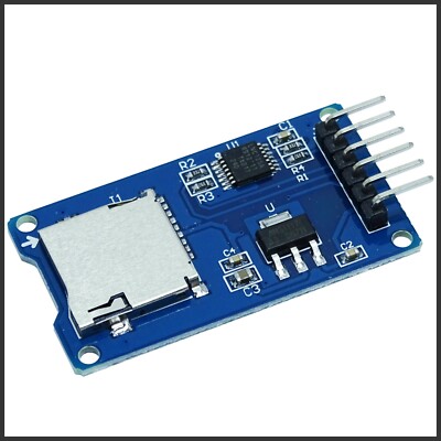

Removing the pull up resistor did not solve my problems with some SD-cards. I think that the spark shifter board could be the problem. I will try another board with some cables as connection to the tashtwenty.
I really don't know how to account for all the trouble that these things have been causing. I developed the firmware using one of the SparkFun boards and it worked fine for quite some time, and worked fine with my first build of my PCB as well, then it suddenly stopped, and then neither it nor any of the ones I bought since then have worked. Something something solar flares? Adafruit's board has been much more dependable, thankfully.

So I went looking for potential points of card incompatibility and I found this StackOverflow question - implemented that fix in my firmware and now can use the one SD card I had that didn't work. @Iesca is sending me another troublesome SD card that should arrive tomorrow, I'll see if this makes that one work as well. No guarantees, but I feel optimistic that this could be the cause of a lot of the "this one works, that one doesn't" situations folks have been having with SD cards.
Interesting. Is the firmware available? I've slso run into issues with a couple of my uSD cards. My 1704s and PICkit3 have arrived, so willing to give this a spin and report back.
