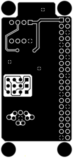

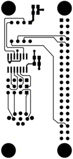

Finally got a chance to get some work done on the hat...
It's setup to fit directly on top of a Pi Zero-W, and I wanted to put the pin names for the Pi's GPIO header on the board's silkscreen, but there just wasn't enough room.
I also don't have any ICSP pins for programming the PIC on the board yet. In the final version, I'd rather not have to pop the PIC out of it's socket to do a re-flash.
It's preliminary, and untested, but here's what I've got so far:

Solder side copper:
Component side copper:
A couple of thoughts:
  • All normal mac serial cables are crossover. DCE/DTE isn't a thing in the mac world. Localtalk boxes would also rely on straight wiring. To me, having the jumper for crossover/straight is an invitation to people making it not work and then complaining about it. Pretty much nothing else that plugs into Mac serial has a crossover/straight switch.
  • I don't see any TVS diodes; and you just know someone is going to be running this attached to a phonenet network that runs out a window, or something. I was looking at the SM712/SP712s which seem to be very available (even in the JLCPCB SMD assembly process)
Yes, but you can't always get a Mac-specific cable. Hence the jumpers.
TVS diodes will be added... as mentioned, it's a preliminary layout. I generally put them on everything unless the chip already has it built-in.
Interestingly, both DigiKey and Mouser seem to be out of inexpensive RS422/RS485 TVS diodes. Had to order them from China via eBay. Won't be here til' December, though... so until then, hooking it up to anything that could exceed the ESD protection of the ISL83076EIBZA is strictly verboten!
You could use a serial/spi/i2c bootloader so that you don't need them :)
A firmware update function in the serial protocol (it'd have to be done over the UART, there are no pins free for anything else) would definitely be a useful bit of functionality. I've looked into it a little and it's doable - the PIC12F1840 has a self-write function - it's just a matter of upsetting the delicate balance of the existing code. Regardless, though, having ICSP pins on the board is still definitely a good idea in case of bricking, &c.
