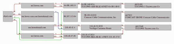

Here is some Robtex graphing goodness to give you a good idea of what your domain looks like.
We can see the A-Record is being picked up just fine. Those nameservers are used by hundreds of people, so a service outage would be fixed quickly and likely not seen again for awhile. I do not suspect DNS is the issue at this point.
