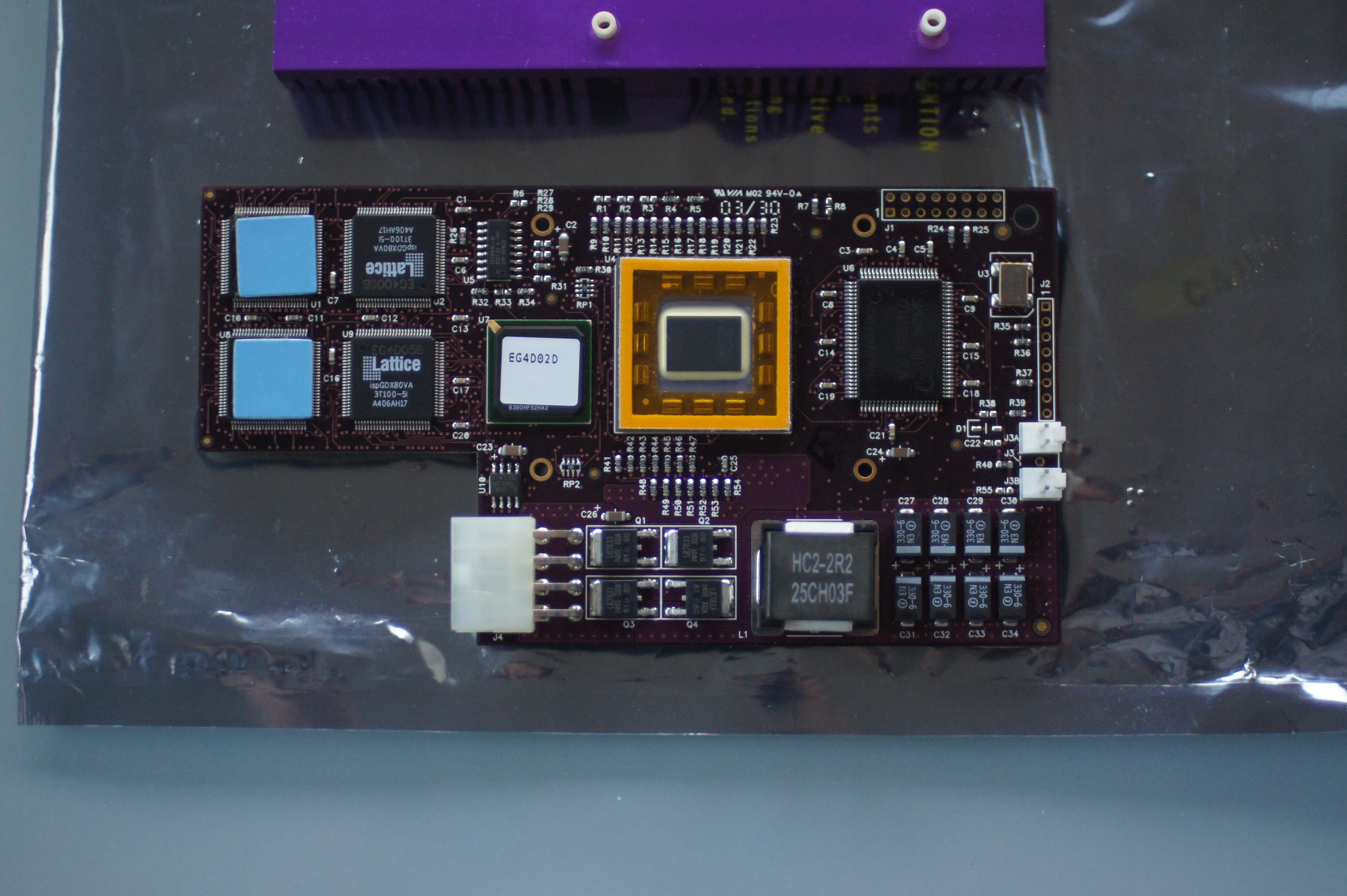

Under the heatsink of an Encore G4/ZIF
So, a couple of months ago I managed to get my hands on a Sonnet Encore G4/ZIF 1GHz, possibly the fastest G4 upgrade for the PowerMac G3 and "Yikes!" G4. I couldn't find any pictures of how the card looked under the heatsink on the Web, so I decided to take some and post them here, as this...
