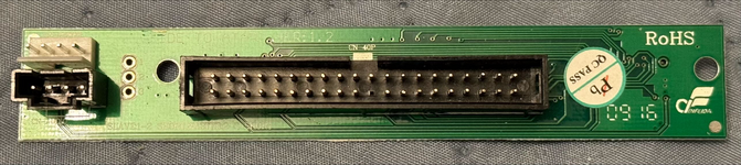

In the video, the IDE adapter he used had a connection for a laptop IDE connector and made a custom cable IDE cable. I wanted to make things a little simpler so I looked for one that offered a standard desktop IDE connector. In my search, I settled on this one that I acquired from Ebay.
Here is Ebay link for the part. Looks like the seller still has some in stock at the time I post this:
https://www.ebay.com/itm/2713400308...R5CuTba&var=&widget_ver=artemis&media=COPYthe
The reason I chose this one because this was the only one that I found that had the option to select the Master/Slave drive option via jumpers (more on this later). I also took a chance on this version since it was not a “slim” model and it stuck out more one one side. When I 3D printed the bracket, I soon discovered it would not fit with my choice the drive IDE adapter.

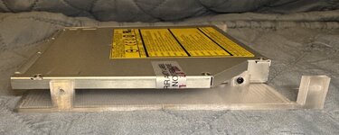

Here is the the drive screwed into bracket. I believe I used 2mm diameter laptop screws. The ones on the side were 4mm in length and 6mm in length to mount the IDE board.

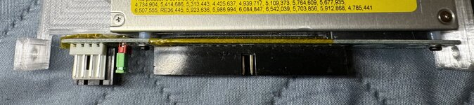

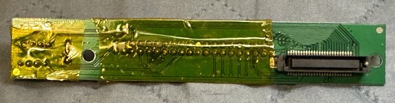

As a precaution, I before I mounted the IDE board, I used kapton tape on the side with the leads to prevent any chance of an accidental short.
I needed some spacers for the IDE board, so I improvised them by cutting some PFTE tubing that I had from my parts bin for my 3D printer. This is how it looked when it was screwed in:

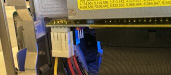

Next came to install The drive into into the computer. I have to give kudos to the original designer of the drive bracket. It fit like a glove in the G4 Cube. Here It is installed in my G4 Cube. I used the original screws from the old drive to install. I was concerned about width of the IDE board sticking out or not fitting because it was not slim, but I was relieved that it was not an issue and fit very well. Next to the power cable of the drive, is the IDE jumper. It is the green jumper. I currently have it set to "slave".
