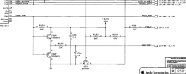

Interesting, well i wish i knew if i had proper version of 6.0.7 on it, or of there is a more specific version for portable?? When i installed a chose under customization to do portable etc. i wish i had more memory lol.. maybe system 7 would be better??@imactheknife On mine it's very noticeable, the lowest end of the slider makes the display quite faint. FWIW I did see a difference in your video, but it was very minor - certainly should be more.
I have doubts 7 would make a difference, and likely will drag without enough RAM. I'm using 6.0.8, seems good. This might merit a look at some docs to see how the contrast is being controlled... I'm not sure what the control panel is doing exactly, but it might be discoverable looking at tech notes and the schematics.Interesting, well i wish i knew if i had proper version of 6.0.7 on it, or of there is a more specific version for portable?? When i installed a chose under customization to do portable etc. i wish i had more memory lol.. maybe system 7 would be better??
Would it be something on logic or lcd? It is recApped etc and working excellent otherwiseI have doubts 7 would make a difference, and likely will drag without enough RAM. I'm using 6.0.8, seems good. This might merit a look at some docs to see how the contrast is being controlled... I'm not sure what the control panel is doing exactly, but it might be discoverable looking at tech notes and the schematics.
I honestly don't know - I'm not familiar with the LCD circuitry. There *are* caps on the panel but they're not so prone to leakage as on the 1xx PBs afaik. Others have recapped their Portable screens, but I'm not sure if it was to address contrast issues. I wish I could provide more certainty here. I can take a look at some docs later and see if anything becomes apparent.Would it be something on logic or lcd? It is recApped etc and working excellent otherwise
