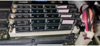

The IIsi also, curiously, has come with 4x 8MB SIMMs. I believe these would not work in an SE/30?

I wasn't aware that they made 8mb 30pin sims, I mean technically I think there's 12 address lines available on a 30 pin sim so in theory I think that allows for unto 16mb sims but im not sure they se/30 can address more then 128mb total using 4mb sims aways...
Here’s a pic of the SIMMs. They’re basically 16MB SIMMS with half the chips missing.98BF08D5-E2A2-4123-A137-6B6011771F79.png
