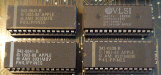

As documentary evidence, some photos of my unit, including a closeup of the suspect "missing" pin:
Pretty sure you need IIx/IIcx/SE30 ROMs for those things to work. The original non-FDHD Mac II ROMs don’t know what to do with a 030 CPU and will fail very early in the boot process.
Mine has the IIx ROM and a SWIM chip installed, and has a SuperDrive as well. It came with all of that and the accelerator (all within a IIfx case, of all things).
And for fun, the relevant ICs installed in my Mac II:
Floppy Controller (VLSI 344S0062-A, "SWIM")
FPU (16MHz M68882)
CPU (16MHz M68020)
MMU (16MHz M68851)
ROMs (AMI 342-0642-B, VLSI 342-0640-C, AMI 342-0641-B, AMI 342-0639-B)
Yes, do make sure your ROMs know what an 030 is. They're not fully backwards compatible with the 020.
Mine came without those things (correct ROMS for an 030) installed when I bought it, but I have the ones from my working IIx that I can put in temporarily to see if they allow it to start.
