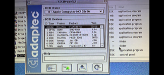

For anyone saying “SCSI is hard!”, I present to you my just hooked up SCSI chain, simply following “the rules”. Booted and works first try without issue.
