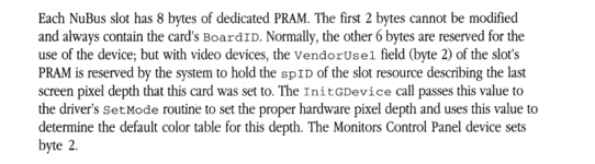

Yes, vendorUse1 is set by Monitors control panel and contains the bit depth that will be requested in a setMode call. There's no expectation that the card does anything with this byte. It is still part of the slot PRAM record though.
There's a comment in DC&D about this also.

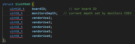

Those offsets look correct. Here is slot PRAM record as I use it.
To make things easier, rather than reverse engineering from scratch you might have a look at the attached pickles sources for an example of how they handled early initialization/etc. The supermario system 7.1 dump also contains quite a bit of useful video code examples.
Ah! Those are the magic words I was trying to skim for in the documentation. I think my eyes skipped right over the middle of that paragraph.
So I think the offsets I pasted above should match the disassembly. Crucially, it should help us understand what section deals with the physical output configuration, as that would be reading from -61(a6), as a short-cut from fully reversing it.
