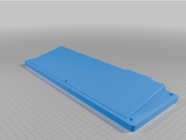

Printing the first draft of the new top-case now. I'll post that when I have something I'm happy with.
Case is in "public beta" I guess.
