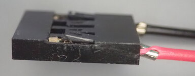

Third, if you want to avoid splicing wires, you can obtain the correct part as Amphenol ICC FCI Mini-PV Basics rectangular connector contact crimp socket 48236-000LF. They are several variations based on surface coating and spring force. For a two-pin connector, you want the maximum spring force. As far as coating, I was disappointed that the gold is only present on the mating surface, rather than all exposed metal. Oh well.
Below is a comparison to the original socket. It sure looks like a perfect match.
If you use a slightly wrong socket or you insert the write too far, then the socket may not fully latch in the original plastic receptacle.
A replacement receptacle is Amphenol ICC FCI 4 position 2.54 mm rectangular connector housing receptacle 65039-033ELF. To key it against being inserted in reverse, shove a white plastic polarizing key / post / plug Amphenol ICC FCI 65307-001LF
