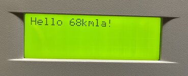

This a story of one of those computer you never though you will ever see for real. Then you got one.
I'd like to start with a warm thank you to @zefrenchtoon who put me in touch with the seller of that big lot of macs in France, and of course, many thanks to the seller who was absolutely nice. Big thanks to @jajan547, without his help to find an ANS ROM, this work wouldn't be possible!
So here we are I'm in my car with an ANS 500/132 travelling back to home, so much question in my head, how I gonna find an OS for this, this, how I'm going to find a ROM. And how I'm going to find proper memory? By the way... How I'm supposed to plug and hard drive in this thing... Will it ever work?
The ANS wasn't in a great condition, it was dirty, missing half of the disk carriers, had some corrosion, is missing all RAM, ROM and cache sticks. But I knew it was worth trying to get it back to life.

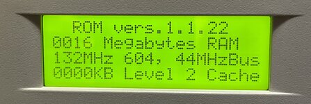

The ROM problem was quickly out of the equation thanks to @jajan547 and it allowed me to grab a backplate for a disk carrier in order to install a SCSI narrow drive.
