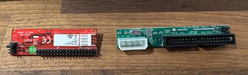

I've bought two different SATA to PATA converters. Both sort of work in that I can see the drives and format them, but they're either not bootable or when they do boot, my Apple black USB pro mouse inexplicably doesn't register clicks (though the cursor does move).

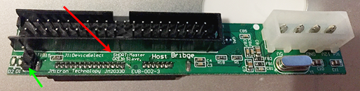

For single, multi-partitioned, multi-boot (OS 9 and X) SSDs

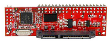

- have had great results with the EVB-002-3 “Bribge” adapters.
For dual SSD or SSD + conventional HD configs on same IDE cable
… the pricey StarTech, Addonics or other “red” (Marvel chip based) adapters.

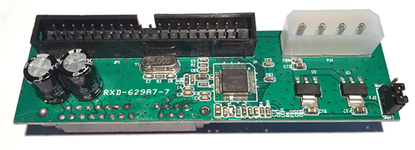

Or even the lesser cost RXD-629A7-7 adapters for similar dual drive setups.

I have tried both of these adapters with the above symptoms.

You might test again with that StarTech adapter’s jumper set as “Cable”?
I lean towards Master / Slave jumper settings with Quicksilvers.
However the recent 933 here… seems to prefer Cable Select.
