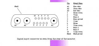

- Apple 13W3
1405790753_2018-12-1108_27_20-AllYouEverNeededtoKnowAbouttheAppleM350221inchFixedFrequencyDisp...jpg

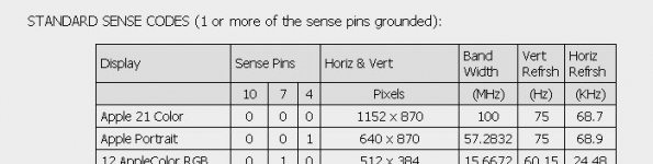

- Sense codes for the Portrait Display
2018-12-20 21_52_04-Macintosh Video to VGA adapter pinout and wiring @ old.pinouts.ru.jpg
My questions are:
- is Comp/Hor/Ver *return* on the 13W3 equivalent to Comp/Hor/Ver *ground* on the DA-15?
- I guess I have to ground pin 4 to let the OS know there is a Portrait Display connector, right? In that case, is it pin 4 on the DA-15 that should be grounded?

Sorry it took so long. This is what I came up with. Haven't tried to figure anything out, just buzzed the connections for raw data. You're looking at the pins on the ends of the cable.
Thanks you so much jt, I'll try to build the cable as soon as possible.
That pin-out makes very little sense according to the schematic I've found but I guess we'll have time to figure that out.
The cable buzzing data appears to match this pinout table.
Dunno about the sense pins. Do a markup of my drawing with the 13W3 pins numbered, that would have been my next step, but I ran out of time.

I toned out my portrait display cable a while ago for another member.  It's a little different than what jt posted.  Mainly the outside barrels are swapped, and there is no short between pin 4 and pin 7.  Drawing is while looking at the cable ends.
That's very odd about the coaxial connector swap, but makes no nevermind on a grayscale display. You're running RGB tied together(?) and it shouldn't matter which is which I would think.
The pink critter on my diagram is the same connections to pin 11 that you show on your diagram, it just looked different to me for a bit.
The cable I buzzed is definitely set up for the 21" Two-Page Grayscale Display, having 4 and 7 tied together. They must be Sense 0 and Sense 1.  For the Portrait Sense 1 needs do be in the same state as Sense 2.
https://users.soe.ucsc.edu/~davis/projects/mac/monitor.html#msp
The three tables below summarize the contents of this tech note.
Table S-1 Sense Line Code Assignments
Monitor Type Sense 2 Sense 1 Sense 0 Frame Rate (Hz)

It's just stupid to have Monitor ID, bit 1-3  in one place and Sense 0-2 in another.
