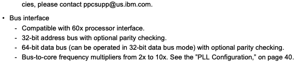

but if one checks the datahseets, only the PPC740L supports a 32 bit 60x databus, the Motorola 740A in all the data I can find on it makes no mention of supporting a 32 bit data bus, but the IBM PPC740L datasheet explictly mentions supporting it

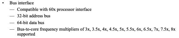

vs if you compare with the MPC740A
only a 64 bit data bus is mentioned
so I am a bit perplexed as to why an explicitly incompatible CPU was tried, and then whole idea written off it seems? I say its worth revisiting with an actual IBM PPC740L and see if one gets better results with that :)

as a fun aside even the 750GX's datasheet specs 32 bit data-bus compatibility, so that could be quite a fun upgrade in itself :) especially because if I am reading things right the NuPower does bus-speed clock doubling like a Mach5 card?, if so you could have some real fun with that since you would be free of any multiplier constraints, 1Ghz PowerBook 550c? :)
