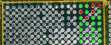

Now, looking at the BGA grid, what jumped out at me is that it does appear like not all data bus lines are attached, which would confirm we're likely operating in a 32-bit mode, but it seems like both Data High and Data Low are connected, but each presumably half.
I mapped out some, green marked pads are DL, red marked pads are DH:
Some go to vias, some don't... which I can't quite understand, as that's not how the 32-bit mode on the 603e is supposed to work, as the 603e User's Manual states:

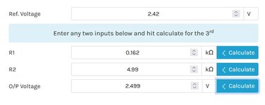

The card uses an adjustable LT1507 500KHz 1.5A buck converter to generate the 2.5V vCore for the CPU, which uses an internal reference voltage of 2.42V, which is used to generate the right output voltage with two resistors adjusting it.
The two resistors can be found below the diodes and coil, with a 162 Ohm resistor at R818 (R1 for the buck converter), and a 4.99 KOhm resistor at R819 (R2 for the buck converter).
Throwing that into a feedback resistor calculator, confirms this to generate 2.5V as expected:
OK, never mind that, just realized I stuck to my tradition of getting BGA/PGA grid orientation wrong, correcting that does make it seem like it is following the 603e 32-bit mode (DH lines connected, DL lines left unconnected).
So that at least confirms the theory that the card is running in 32-bit mode.
In the meantime, I did get the BGA PowerBook 1400 CPU card, and can confirm it too is only wired up for 32-bit.
That makes it more likely that PBX is a 32-bit data bus only device, in lieu of datasheets, pinouts or schematics.

I swapped back to the old buck converter, set it to 2.5V as before... and it's working again.
Not sure why it won't work with the other one, seeing as the voltage is correct (and not dropping significantly or such).
I'm also growing a bit worried about those AliExpress 745BPXs, they are a dark shade of green to the point of seeming black... but this one on AliExpress is much, much more obviously green, which makes me wonder if mine aren't cooked to hell and back...
Not much progress made so far, I'm afraid...
Small but annoying update on the buck converter swap... it doesn't work, and I don't know why.
You're talking about swapping from LT1507 to CS51413? Could it be that the CS51413 has too much ripple noise on its output, or perhaps just noise at a different frequency that affects the CPU operation? It seems unlikely that a ripple noise problem would be severe enough to completely stop two different CPUs from working, but stranger things have happened. Without checking with a scope, it's hard to say.
Yes, it was that swap I was referring to.
It probably will have to be something like that, knowing the 603e works just fine at the same voltage, coming out of the LT1507.
As mentioned, LBF did ask a PSU designing friend of his whether the frequency difference would matter, they said it probably wouldn't.
Then again, that person didn't know the full schematic and such, so there could be "obvious" problems to an expert that they simply couldn't know of.
