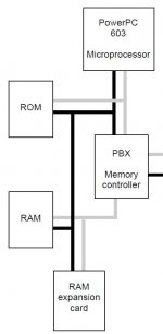

Here's your Duo 2300c Block Diagram, it's exactly what's on your Blackbird PPC Upgrade target as I understand it.
2300c
The block diagrams of 2300c and 1400 are all but indistinguishable.
1400
edit: at this level (FSB?) the 2300c and 1400 are identical but for the CPU board interconnect.*** The Delta DevNote for the Enhanced 1400 (166MHz/Cache) doesn't provide a block diagram update for the CPU card unless it's on one of the pages that appear to be blank.
*** Different Max RAM provisions are mere details related to intentional hobbling of the 2300c/PPC upgrade path that Apple had promised, but never really wanted to ship for the Duo System. With IDE AND SCSI buses on board for HDD, Color AND Grayscale connectors for LCDs on board makes the 2300c the Swiss Army Knife of the PPC menagerie. Plans were to hang T-REX/PCMCIA Card Cage of the 1400 off the Duo's Docking Connector. That's why there is so much vacant cubic underneath the PCB in the UltraDock series. Getting that setup running has been a sporadic journey of fifteen years.
I had no idea the 2300 was so similar in architecture. I can completely see what you are talking about. It appears that our two projects do certainly intersect. Anything you learn can be applied to future plans for the BlackBird project, and vice-versa.
