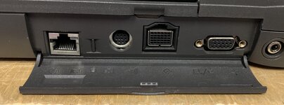

Replaced the rear port cover today. Since I never had a rear cover, I didn't know exactly what it looked like so I had to model it based on the opening in the back of the laptop. So definitely not going to look like the stock one but still follows the curves of the rear, etc.
Design:
And here's the final installed:
Attached the STL model file for it to this post.

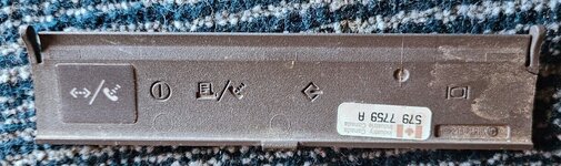

I don’t have a 3400 but remember someone saying the 3400 and 5300 were similar in terms of body and your picture suggests it’s pretty close? I am curious whether the STL model I included works on the 3400 as well? It wouldn’t surprise me if Apple made them the same to save costs.
I have both doors, although of course both of mine have one of the little clip things broken. They appear to be a close match, but the port legend on them is different. I'm not sure whether they will fit each other or not, but my guess is that they would. I can test this when I'm home this afternoon.
Cool, let us know. Would be cool if the door is the same on both.
thats a good idea for comparison..
and yes the two little clips left and right seem to be the reason why the doors often miss.
