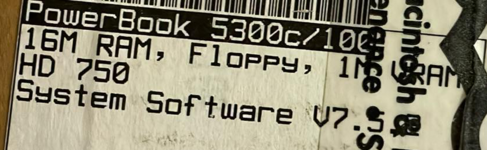

Basically he worked for a company that bought a whole load, as desktop computer replacements, then sold them back to the employees after a year for £100 each or so. People must have hated them!
Ask what desktops they replaced - I'm curious if the laptops were slower or faster :ROFLMAO:
As for the batteries, I think the “tabs” they are referring to are small strips of metal, not the “nubs” on positive terminals. When I got my 4/3A cells, I ordered them at batteriesplus…and they wrap up the cells and tack weld on tabs for you free of charge.
That's a horrible price drop for only a year... What version of the 5300 were they?
It's mentioned earlier in the thread, but here's the spec with a pic!
Brit Macintosh affacciandos may recognise the edge of the logo at the RHS: they were bought from Jigsaw, a big mail-order Mac seller in the 1990s.
