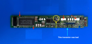

I had an issue with the one pointed at by the blue arrow on one of my batteries and had to replace it. (Ignore the other arrows, I am re-using a previous picture).
Mine wasn't physically broken like yours (or maybe it was, I just wasn't visually able to see damage).
Just curious, which transistor went bad for you?
It was the transistor immediately to the right of the one labelled with the blue arrow in your photo.
