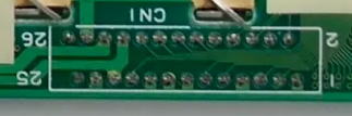

Does anyone know the make/model/part number of the ribbon cable connector on the PB170 LCD? This would be part of the Hosiden HLR1014 and not in any Apple service manual. I have one here that won't make proper contact even though it's been cleaned and reflowed.
Pics for reference(source):

That'll be an obsolete part. I'm guessing pitch is 1.25mm for that end - Molex 0039532264 is not ZIF but might've worked. In any case, being in your situation, with a bad connector and a bad ribbon, what I'd do is hardwire the panel to the interconnect board using something like 80way IDE ribbon cable. It's a lot of work, though.
I'll go look at my bad 180 panel later and get proper measurements off the display PCB (I yanked the connector on that to wire it directly and have no idea where I put the actual connector). That might help find a replacement.
That looks like it could be the part. Thanks for finding it!
