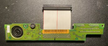

Here’s the finished article. Notice the way that iron filings always build up on the speaker membrane on these interconnect boards.

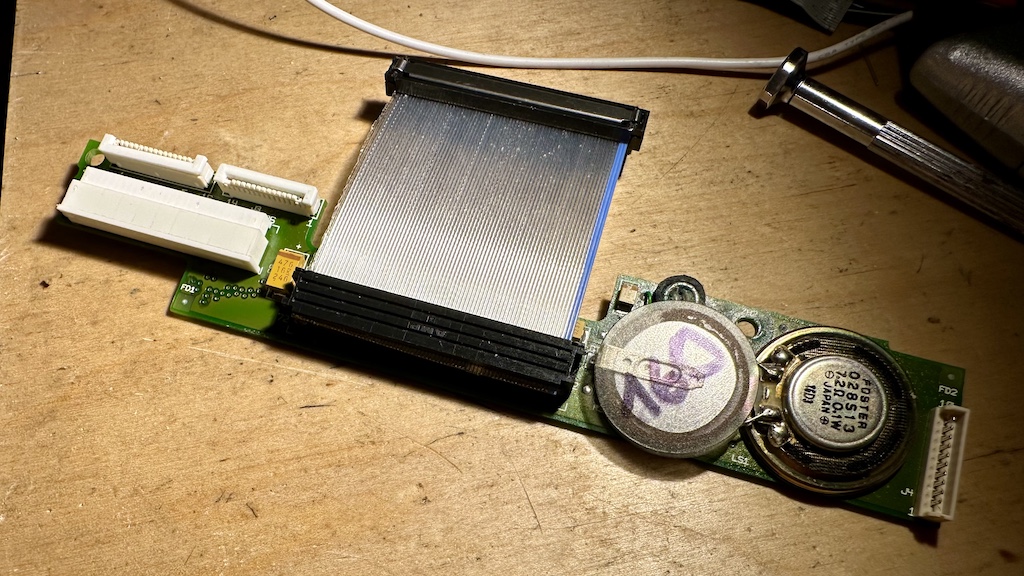

Also I highly recommend that every PB140-180 owner consider replacing their DC barrel jack. I have found these are failure prone, but not in an obvious way - with dry joints - like on the PowerBook 190/5300 series. Instead, you'll get intermittent shutdowns, failed boots, and other odd behaviour. I got a pack of these on eBay (see image below – not pushing this particular store, it's just for reference). Swapping this part out solved all of these problems instantly.

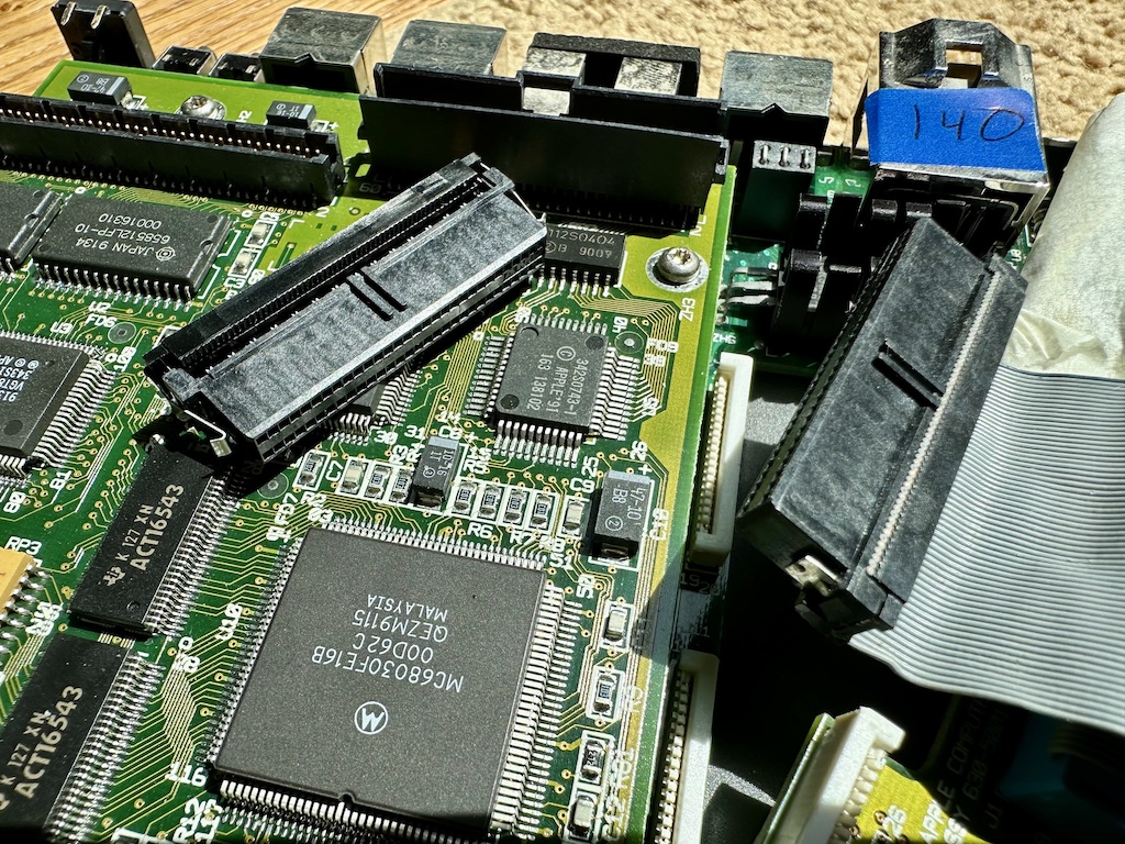

Found this while looking for something else: the PB140-460 connector (60 pin one) is still manufactured, although it's a revised design (extra metal clip). Unfortunately this design isn't available in 72 pins.
Reference is TE Connectivity 2-111196-2. It even still has the old AMP logo from the mould :)
Any luck tracking down the connector on the interconnect PCB end? There's an early blue one that's worse than the AMP one and impossible to get off intact.
The connector appears to be called AMP/TE System 50 according to this catalog. Part number for the plug end for the 72-pin cable is 2-111196-3. Part number for the board end for the 60-pin cable is 1-5111595-2, 1-5111595-4 for the 72-pin version.
