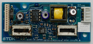

Backlight Inverter board
C6
C1 - ?
C3 - ?
C4 - ?

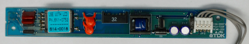

Display panel
C11
C17 - ?
The inverter board and display board caps all appear to be small through-hole components.
First, the second board is part of the backlight inverter, not the display board. Also, any purple cap that you see there is a solid polymer and doesn’t need to be replaced. Not sure what’s up with C4, probably wasn’t populated from the factory?
LCD itself has some through holes. Don’t have the values on my website yet, but this should help:
There are only two caps that need to be replaced on the inverter board. They are 8.2uf 80v. They are kind of hard to find at that size and measurement. I found some on eBay that were much taller. I ended up bending them to fit. It worked out okay. Clean the contrast and brightness switches as well.
