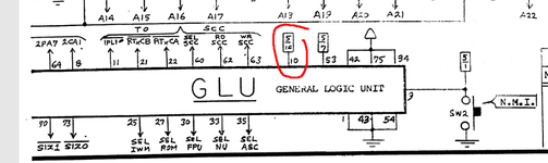

On at least the Macintosh II 820-0163-B and earlier boards, holding down the power button early in the power-up sequence does not power off the Macintosh. This is because the power "off" portion of the button originally connected to input pin 10 of the GLU chip, and the GLU chip has to be set to perform a power off.
If there is a defect on the board, such that the computer doesn't make it far enough in the power-up initiatilization, then holding the power button does nothing. It will not turn off. You need to pull the plug. This is not caused by a corroded trace. It is a design limitation.

On at least Macintosh II 820-0228-A revision, Apple made two important changes: They added a power-on delay circuit and they directly wire the power-off button to the power-off circuit (bypassing the GLU chip).

On the Bomarc schematic (see below), C3 provides a power-on delay. When the computer has been powered off long enough, C3 will have drained through R9 (which is essentially grounded because power is off) and reaches a low voltage. Pressing the power button drains C6 (which had a default high signal via the battery through R18) which turns on the machine. Powering up causes C3 to fill up to 5V through the power supply through R9. Great. The machine is powered up.
When the user presses the power button to turn off the computer, C3 is now high (not low) because the computer has been powered on. Until the machine powers off and C3 has time to drain through R9, C3 cannot provide the low signal to turn the computer back on. Thus, instead of the computer repeatedly restarting immediately, it turns off until enough time has passed to drain C3 and start the power up cycle again. R9/C3 is a delay circuit.
In the above schematic, I've also circled a line coming from the other half of the power button. The power button is now directly connected to the power off circuitry. It no longer has to be processed by the GLU chip (or ROM code) to power off the machine. No more pulling the plug.
Below, we note that pin 10 of the GLU is no longer used and is simply pulled high through the resistor pack. I imagine you could add a power off switch here and it would still work. Not sure why you would do so.

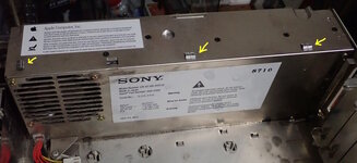

Another oddity on this particular Macintosh II are three ground contact fingers atop the power supply. I haven't seen this on any other Macintosh II power supply. The contacts do not appear on other power supplies with the same part number: CR-45 (68-1073-5) 699-0389 REV E6, M23. Yet, they seem like original OEM.
They make contact with upper RF shield on the lid of the Macintosh II. I assume this improves RF suppression?
