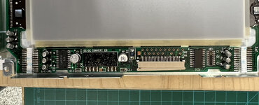

This was apparently the second LCD inside this PowerBook 160. I was told the previous one had died, been recapped, but still didn't work, and so a second LCD was acquired, that worked for a few months but then also died. A new inverter board was also acquired but that did not help. I took the PowerBook apart and here is the display capacitors:

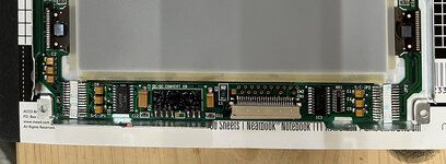

Capacitor leakge was visible, there was some minor corrosion on the pins near the various capacitors. Some of the capacitors were barely hanging on (as you can see from the photos) and one of the pads was lifted (C1) and barely hanging on. The picture above was with the capacitor still on the board but I had cleaned up the corrosion. After removal of the capacitors, you could smell the leak. Yuck. I took the old capacitors off, cleaned the board, fixed the pad, cleaned up the other pads, and put new tantalums on:
@3lectr1cPPC's capacitor list was correct and allowed me to get the capacitors ahead of time so that after taking apart the unit, I could go to work right away instead of reading the capacitor specs and waiting to order the replacements.
