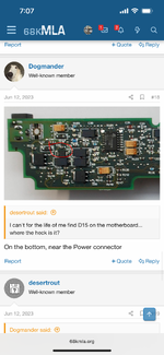

Right where the power supply plugs into the logic board there is one thing that blows up in the back side. Will have to take a picture and show you. But take a look and see. It is a little black rectangle. There are a few other things that it can possibly be too. Will do some research
Protection diode. Yes, it's a common failure point.
Hi, thank you. The diode you mentioned looks good to me. I cleaned the board thoroughly with compressed air and IPA - so far it boots up nicely. Maybe it was dirt somewhere? Odd.
Just general 100 series weirdness. You might find the issue comes back later on… or not ¯\_(ツ)_/¯
