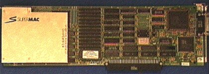

Acceleration on a card? re: missing daughtercard for LaPorta's SuperMac ColorCard/24:
MacOSMonkey
It was a GAL-based accelerator board. Without it, the card is a standard 24-bit 640x480 frame buffer with all of the typical SuperMac features, as shown above. Fun to see the old ad.
Has anyone got that daughtercard? Hi res pics would be greatly appreciated. Hoping it will yield some clues about the general machanics of an early implementation of QuickDraw Acceleration?
Might dissecting GAL formulas be helpful? If not, sorry about the tangent, M.
