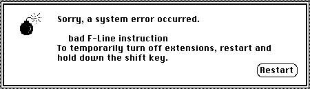

@cheesestraws First, thanks for the example! I could use the project as well, as it seems I didn't get it right on my own. Trying your code in my project, the main() run fine (like with my own similar attempt), but 8.1 freezes after loading the extensions, presumably at the point where it would draw the menu bar. main() is called and finishes fine, but it seems the callback is never called (after trying the 'vanilla' code I added some debug write to my virtual framebuffer that Qemu forward to the console, so I have low-overhead tracing). I _guess_ it crashes when calling the address put by SetTrapAddress.
I tried 7.1 as well, which crashes 'nicer' by telling me 'bad f-line':
Currently I have CW11 installed, but I can add a newer one, just need to know which version the project is using.
