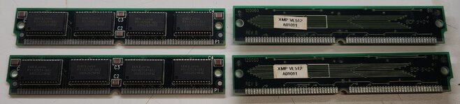

Got a few of these at VCF. They result in display corruption on a Q650 and some oddly partially functional effects on a Q605. Interestingly, VRAM tests pass. Seems like they don't agree with the actual display output. Anybody have a clue what these go to? They're 512K, 80NS.
Wild guess, "GWorld" SIMMs?
Hmm, I don't think so... Those look to be 64 pin and use DRAM, these are 68 pin and have VRAM chips.
Might be for an LC. I have a 68 pin SIMM out of an LC II, compared it to a 68 pin SIMM out of a Q610 and the pins ... don't exactly line up with each other.
Went on a bit of a quixotic quest and made some headway. TLDR: It's LC2 VRAM. Presumably third party.

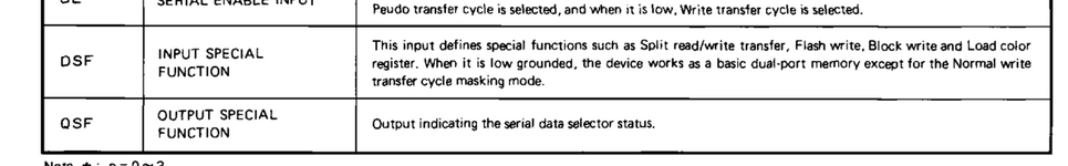

The VRAM chips used on these (OKI MS514252A) don't support the JEDEC special functions DSF/QSF, which Quadra 605/650 seem to need. This would align with the chips behaving as expected (VRAM testing OK) when accessed via the independent parallel bus interface.
From the Micron MT42C4256 datasheet, used on the working SIMMs:
DSF (pin 22 in SOJ28 form factor) is wired to both the internal VRAM (if applicable) as well as pin 2 on the 68 pin slot. Interestingly, the mystery SIMMs are also wired correctly for DSF, just the chip doesn't support it.

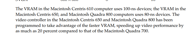

LC3, Q700, Q900: 256K. 80ns. DSF is implemented on the VRAM connector
Q475, Q605: 512K. 80ns. DSF is implemented on the VRAM connector

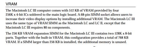

LC3:

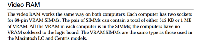

Q650 devnote:
Q605 devnote:
