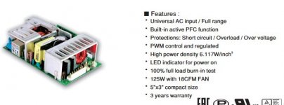

I'm not a fan of dumping any old PSU into an Apple Power Supply Can without airflow/cooling analysis. Heck, I'm not sure Apple did all that wonderful a job of specifying what went in their own cans from the get go. I just took a look at the PPT-125B Datasheet:
Seems like it calls for 18CFM of active cooling in something more like the open spaces of a piece of stereo equipment. Methinks it's not intended to be haphazardly stuffed into a metal crate with holes on top and bottom for half-assed convection cooling that's aided by just a small fan mounted above and at the back that's expected to cool not just PSU, but CRT, A/B, logic board and all the crap whith which we're packing the SE/30 to the gills.
Could someone post pics of the insides of the real deal? I'm hoping the heat sinks are pretty much aligned vertically to pull air from bottom to top inside the OEM PSU. They were set up in a vertical orientation on the 128-Plus A/B to direct airflow up and out the top vents Jobs didn't think were needed. ::)
Take a look at the horizontal positioning of the Mean Well PSU in the illustration. The heat sinks are three sided sheds with slots/holes in the roof for convection cooling. Turn that assembly on its side to fit within the SE/30 sheet metal as Artmix did and the passive cooling designed into the Mean Well PSU is negated.

jt, in the datasheet, we see it is rated for 125W with a fan, and 100W with convection cooling.  Even with Ethernet, 50MHz 68030, and grayscale, I doubt we'd be using 100W.  I think the convection cooling would be adequate.

I imagine that would be convection cooling with the supply positioned horizontally. I didn't see any specs about enclosures or applications?
edit: copy paste doesn't work: It needs to be in a bigger box.
Yeah, me neither.  The casing of the old power supply has holes all around the perimeter, and with the existing fan pulling air in from the bottom and exhaust out the top, we should be golden.  The nice thing about the MeanWell is that there is not so many wires like there is with the mini ITX.  Makes it easy and clean to make.
Thanks again omidimo, you really nailed it pulling your build apart just to confirm our suspicions.  You're a scholar and a gentleman!  Much appreciated.
Again, it's spec'd to be mounted horizontally to a 14" x 14" x 1mm metal plate in a much bigger box.
Not sure it'll be happy living on its side in Apple's tin, but I'll shut up now. [;)]

Not worried about specific ratings, that's a hint as to how they expect it to be employed. I'm just sayin' it's not really meant for the purpose or orientation in which we're planning to place it. But that doesn't mean it really matters, there's a whole lotta slop in the parts/spec.
