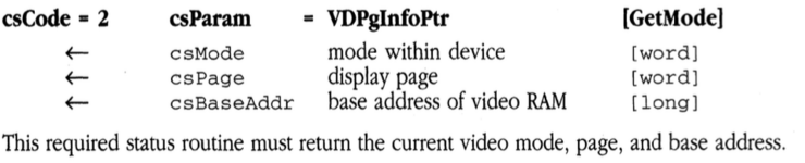

- Harder: there's no central place to get the information we need. Under Mac OS, we can just ask QuickDraw for all the details about screens and so forth. On A/UX, we can't. QuickDraw lives inside the Mac world and if we want to survive across multiple sessions, including terminal sessions, we can't use it. So we need to ferret out information from corners of the kernel, talk to the kernel's cradle around the slot manager and video drivers, and so forth.
- Harder: we can't talk to the hardware directly. Getting access to things like framebuffers can only be done via custom code in the kernel (I hoped to use the user interface driver for this, but we can't). So we live in a split world where there is a kernel module and a userspace component, and at the moment we have to copy the framebuffer out of kernel space, rather than consulting it directly. This adds up to 90ms of latency to updating the framebuffer. There is a way around this, but it requires me to go and do some more disassembly of the kernel...
