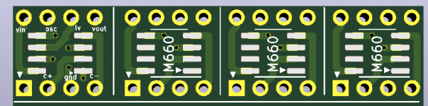

I've also got a breakout board for the SMT version of the MAX660 inverter IC put together. For basically $2 we can have a DIP-style inverter while using the much cheaper surface-mount parts - though if you still want to use the DIP MAX660 you can cause I'll still be providing a DIP package layout on the board. Because it's surface-mount, I'll be including these boards as a pre-assembled component.

Rev2 of the mAcTX LC also arrived today as well as my SMT to DIP breakout boards. The main issue with this revision is that the resistor footprint is too small. I'm also not fully sure what value to use as a discharge resistor - 100 ohm in this revision drags down -5v too much. I'll be experimenting with different values over the next couple of days to see if I can figure out what I should be using.
