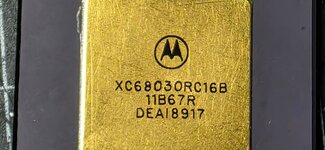

Macintosh SE/30 replace processor MC68030RC16B to MC68030RC30C
I got it: XC is not a guaranteed fail - that was mere speculation.
Still don't know the difference between XC and MC, or why they changed over, but I'm no longer concerned with that at this point.
I'm concerned about fixing the issue of the bus walk and the strange results. I found something with the Y3 crystal, but I'll post that in my SE/30 thread. Thanks.
I should have the new MC68030RC33B CPU shortly, I'll follow up when it arrives.
If in fact my XC is bad, what would have killed it?
Why would Apple switch to the MC68030RC16B, if the XC was good enough? What's the actual difference?
They switched because Motorola stops making early access labeled parts once the part goes into full production. There were no more XCs to buy.
The difference is chip-specific. Could be nothing at all, just a paperwork thing. In some cases Moto moved to a smaller process node when they went to full production. I re-stress: there is no known systemic reason why this should be an issue. And it's not just 680x0 CPUs that have this labeling phenomenon.
Am I still overthinking this, or is there another answer as to why my particular CPU is not 'walking the bus'?
If you replace the chip and it is still not working, then sterner investigations are called for. Do you have an oscilloscope?
