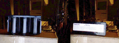

Basically what you want to do is use Nail Polish Remover, Set the battery upside down in a tubber ware and fill up about a 1/4 inch past the seam,
let it soak for about 4 hours... ( this i did not do ) i was impatient, finished with a dremel.
you can see the seam that i did let it soak some and it came right apart with the twist of a flat head.
Anyways I found a good replacement, It's 6v and 5.0 AH, Fits nicly!
19.99 at batteries plus.
Check pictures for exact model #
Its pretty much complete, just letting it sit for a while to make sure the GOOP holding the +/- pads sets up before I try it.
I like it this way because, i can just peel off the tape, and install another battery once this one dies, this model of battery is very common.
Mine pried apart much more nicely that that with a flat screwdriver. I also soldered and put exact match batteries in. Figured it would last at least a long while that way.
They had that updated composite cyclon replacement but they were 33 + TX , he said its a Z-deck item, I guess that means when they sell all the stock there is not going to be any more ordered, so this is the alternative I found.

use Nail Polish Remover, Set the battery upside down in a tubber ware and fill up about a 1/4 inch past the seam,let it soak for about 4 hours
Acetone (nail polish remover) fumes are quite toxic - with this procedure you would want to make sure there is good ventilation.
Another way to crack the glue bond is to use a fine paintbrush or sponge applicator for the acetone (Goof-off is similar chemically) and keep running that around the seam area while prodding and prising away with a sharp but strong steel blade, loosening one corner first. Once you can lift one corner enough to get the blade in, just paint away at the next stuck part of the joint and follow it around as it loosens.
Rick
Pointed water color brush: cheap set from any art supply store.
Touch up brush set that looks the same from a home improvement emporium.

You want the 5.0 AH cyclone replacement for this.
They are not acutely 6.0VDC, They are 6.7 to 6.6 VDC
and this (.6 - .7V) is critical to make the hard drive work properly!
* theres no way around it * trust me.
( if you are interested in running the HD from battery )
This battery I have chosen sits fully charged at 6.4volts.
It will run Spin/boot from that hard drive, but only for about 10 to 15 minutes (max)
(Once freshly disconnected from the charger) Then as soon as the battery goes below 6.4Volts (witch does not take long)
the HD will stop and not spin back up, even if you are already booted into the os.
If you are booting the os with out a HD or are maybe using Single or Dual Floppy drives or external(tested), It will run for hours and hours no problem, on this alliterative (non cyclone) solution.
I am heading to batteries plus to get the cyclone 5.0 ah replacement.
