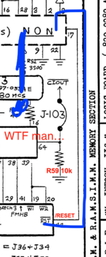

After fiddling with the jumpers on the board I did get a deathchime but only when the jumper to disable the 32k cache was set.
I worked my way through the (visible to me) logic that interacts with the cache, mostly the address decoder PAL at UL6 that generates the enable signal for the four cache chips and the cache tag. It didn't make sense at first because it seemingly enabled the cache right from the start where you'd expect the 68030 to walk the bus in order to find code to run from the ROM.
After a few days of staring at the board (here we are) I found that I missed to hook up the reset line on the cache tag chip to the main system reset:
With that bodge in place the board did instantly chime (good chimes even without RAM, because everything up that this point seems to fit into the 32k of SRAM before it locks up)
Want to know how the Bomarc schematics indicate this should be hooked up to the main system reset? THEY FRIKKIN don't. Instead there's just a single line drawn to the parity generator. If they would have just let it out I would've investigated and noticed it while drawing the schematics.
