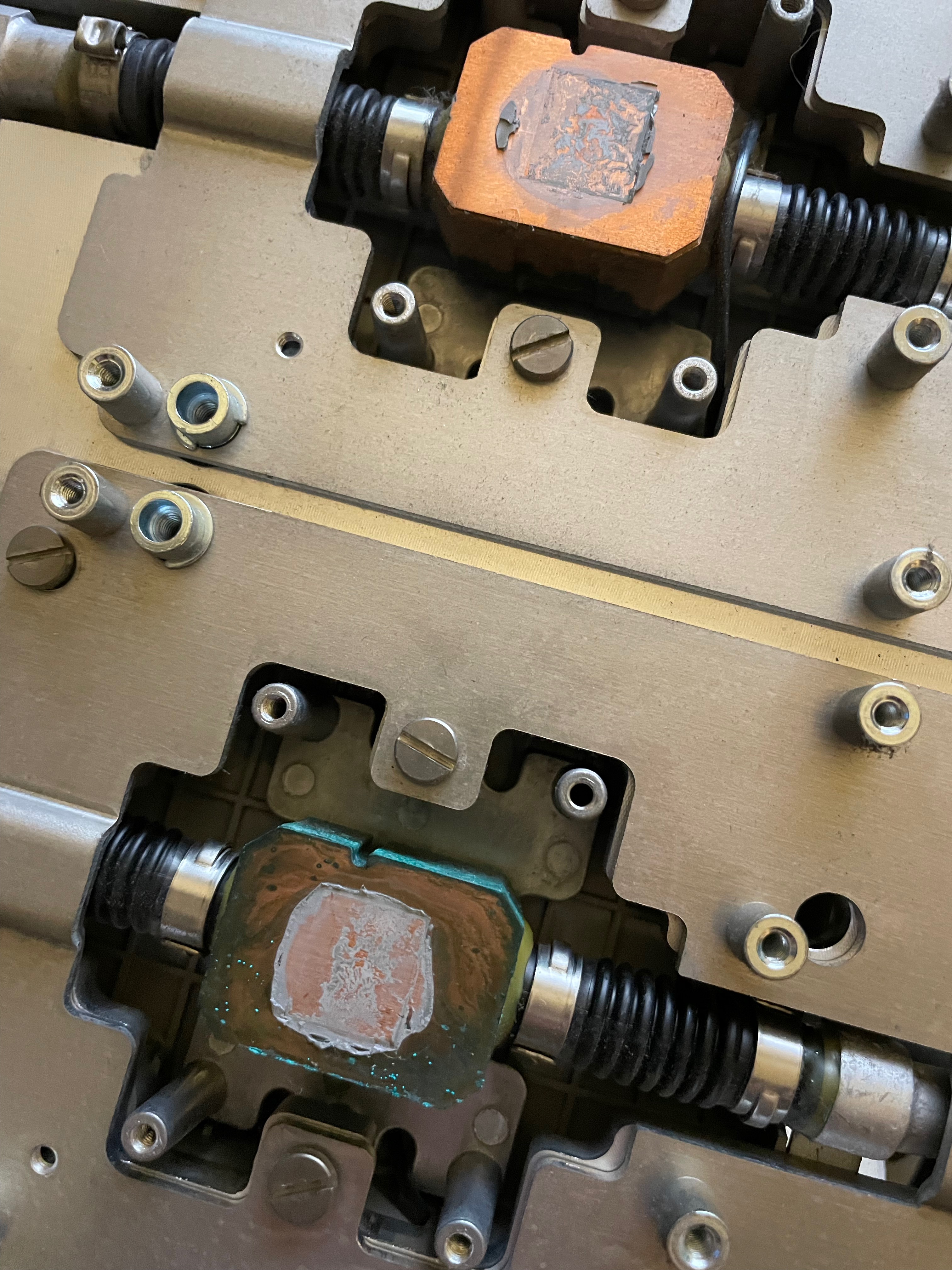

At a basic level, that’s the mod - I’m going back in for two Quads I have to immerse the radiator and blocks in an ultrasonic cleaner. All parts have blockage from solidification of the coolant and the pumps are not performing well as a consequence of this.
I'm back here again, having torn down the Quad G5 LCS (dual pump) completely, including cutting the tubing around the CPU blocks and dismantling as much as possible. The dual pump blocks are solid blocks of copper, welded shut unlike the single pump LCS blocks which comprise two halves screwed tight with an O-ring in between. Technically these later model blocks are "leak proof", but the pressure/fluid will just be released somewhere else in the loop if there is a failure point.
On inspection of all parts, so far it appears it is these small water blocks that are the main source of blockage; if you look inside there are long copper tendrils that appear filled with corrosion - or sediment. I can't blow much air through them, although I imagine they are designed to cause some sort of turbulence with fluid to improve cooling. One block appears more affected than the other, which is unusual and I note they have a direction arrow for water flow.
I've immersed the copper blocks in citric acid for a while and now have these and the radiator cranking through an ultrasonic cleaner. Not much is coming from the radiator (in terms of sediment - last overhaul I had some chunks come out but nothing startling), but I'm hoping the blocks can be bought back as they are not easily replaced If not, I've no choice to look into some sort of custom AIO or air cooling using PC parts.

I sat both the blocks and radiator in the ultrasonic cleaner for a good hour @ 50 deg C: didn’t think much of it but the telling was a layer of greasy sediment on the bottom of the cleaner once drained, presume most came from the rad.
The waterblocks have been sitting in (kitchen grade) citric acid for some time, shiny on the outside (dark inside), but when I blow through there remains more resistance than what I think there should be, and certainly one block more than the other. I’ve worked on several waterblocks before and while I understand the innards cause water turbulence they should not be this restricted. Will find some more corrosive agent and try again. I do note a tall single fan generic heatsink (eg Coolermaster) might fit inside here X 2.
I've ruled out the possibility of being able to overhaul the dual pump LCS:
- The small copper waterblocks are internally corroded and impeding too much water flow. The small barbs either side of the blocks are also looking worse for wear and ready to break. I can just see them degrading further and leaking in time.
- One of the two Delphi pumps are burnt out
- It's quite possibly one of the worst water cooling designs I've ever come across. I've loved water cooling PCs but to have the Quad G5 working long term under water isn't a suitable solution.
I've looked into using an off the shelf pair of "compact" AIO water cooling units and feel none would be suitable considering the weight of the block (with pump integrated), cost and dimensions of the units. A custom water loop (with dual blocks) might do, but it's very tight for two blocks.
