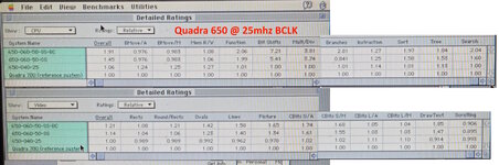

Well, I figured out the branch prediction cache issue. Turns out my 060s just can't deal with 66mhz with BC on; it's the straw that breaks the camel's back. Going to 50mhz clock and it just worked. D'oh.
Here are some new benchmarks. This is also with interleaved RAM. Oddly, the 060 is notably worse at bus access for some reason. Possibly a bug as it shouldn't be any slower.
I did some quick doom benchmarks either. Drumroll please;
040@25mhz - 10.4 fps
060@50mhz superscalar+no branch prediction - 12.4 fps
060@50mhz superscalar+branch prediction - 14.3 fps
040@40mhz - 16 fps
060@66mhz superscalar+no branch prediction - 16.4 fps
060@66mhz superscalar+branch prediction - ??? fps
... it's just that badly optimized. This is a small window and low detail also. Still, it's clear the branch cache is very beneficial. My best guess is doom is extremely memory bandwidth bound currently and is likely thrashing internal caches.
