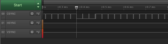

OK, we're in business. I connected up all the grounds, and grounded pin 4 (sense 0) to request Mac 13" inch 640x480 mode. Plugged the adapter into my Macintosh IIci, and connected a logic analyzer to all three sync outputs. CSYNC shows the expected composite sync with a period of 15 ms (66.67 Hz), while HSYNC and VSYNC are high.

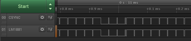

Soldered some wires to the LM1881 PCB. I'm stealing 5V from the Mac's floppy port. Connected the LM1881 S.IN pin to Mac's CSYNC.
But it doesn't behave as expected. S.OUT is identical to S.IN:
I suspect this is why so many monitors advertised both "VGA" and "Mac II" compatibility. The reality is the monitor likely supported SoG and/or composite sync out of the box.

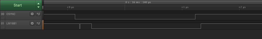

On closer inspection, the signals are not quite the same. LM1881 output lags the csync input by about 100ns, and includes a very short low pulse before going high and low again, for each pulse on the csync input. This might be an artifact of using a logic analyzer here rather than an analog oscilloscope.
That behavior is normal, the LM1881 outputs composite sync and vertical sync (pin 3) signals.

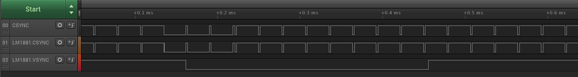

Ahh yes, this LM1881 module has S.OUT connected to pin 1 (composite sync out), and pin 3 (vertical sync out) isn't connected to any pad. That seems very strange, since extracting vertical sync is the whole point of this chip. I'll add another wire.
VSYNC successfully extracted! But it lags the input VSYNC by a whole line, and extends several lines past the end of the input VSYNC. Maybe that's OK?
I would think that lag/extension is fine as long as the VGA monitor isn't too picky. The vertical back porch of the IIci's video output is 39 lines so there's plenty of room to extend the vsync pulse a little bit. It's basically turning the front porch into 4 lines instead of 3, the sync pulse into 10 lines instead of 3, and the back porch into 31 lines instead of 39. Here's the vertical timing diagram from the IIci dev note (note that there's a typo in the diagram -- it should say vertical synch pulse, not horizontal)
Thanks, yeah it makes sense that the exact duration of those sync pulses isn't critical, so long as the period between them is correct.
