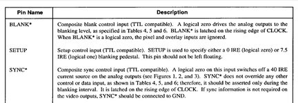

Looking at the 478 datasheet, it only outputs Sync on colours when pin 5 "SYNC" is high. On my IIci, this pin isn't tied high or low, but goes to pin 128 of UE9 "RBV".

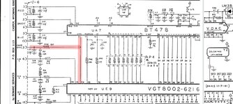

I don't want to probe pin 5 while my IIci is on. I've had this IIci since I was about 13.
Heh, and a reminder of why we don't trust bomarc schematics. The BT datasheet says pin 5 is this, an input :
Bomarc IIci schematic shows it tied to pin 128 of UE9 (correct), but also the Composite Sync on the Video output.
But... It is a digital logic input on the chip. So I doubt it is.
Edit : I take it back, it is. How strange.

I think it's designed such that CSYNC and sync on green are simultaneous. UE9's pin 128 goes to the DB-15 CSYNC pin *and* the 478's sync input. So if the video circuit is driving CSYNC, sync info is also getting fed into the 478, which inserts it into the color channels.
That pin is the actual CSYNC pin, controlled by UE9. It also goes to pin 3 of the DB-15 connector through a series resistor. I don't interpret the 478 datasheet the same way you do though. It's saying that twiddling pin 5 on and off is how you insert sync info into the RGB analog outputs. Not that it automatically gets sync info added when you tie it high.
I don't have a datasheet for UE9 because it is a custom chip, but this suggests sync on colour is software controlled. Given it isn't mentioned in the Dev note for the IIci... I really really suspect it is turned off. Really.

My IIci is fitted with the Analog Devices part.
Interesting! Mine does have the Bt478. They're probably 100% pin compatible competitor parts.
