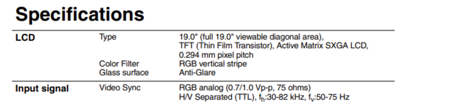

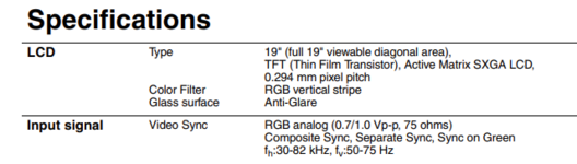

Nice! Yeah, that spec sheet explains why yours works and BMOW's doesn't.
@dougg3 you are the man! Thanks for all that scope data and analysis to confirm what's happening. Am I reading your scope trace wrong, or is the magnitude of the sync signal on the color channels smaller than on the CSYNC pin?
So the Viewsonic VG900b just doesn't support composite sync or sync on green, both from its spec sheet and experimentally, so it can't be used with the IIci. And I must have bad luck because experimentally it seems like the Viewsonic 6 TX-14H30 CRT and the E-Machines ColorPage T16 II 1108DT16MR CRT that I purchased also don't support composite sync or sync on green. I've not been able to find spec sheets for those two, but the behavior matches the VG900b.
I have two other monitors that work OK with the IIci, so they must support composite sync or sync on green or both. They are a Dell 2001FP and a Sony SDM-S51.
