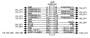

Thanks to a post by @techknight somewhere I had the connector pinout from the Schematics to begin with.
Up front, started late last night. Working from the solder side of the KBD, trying to match the pinout to the connections GND seemed wonky, the MODIFIER  connections weren't making sense and it was making me crazy. Turns out pin 27 GND is discrete network setup for the modifier keys: GND_MOD on my pinout. It didn't help that some of the keys were being pressed all the while so I thought I'd take a look at the trackball I'd ignored as I knew it was ADB. The Numeric Keypad was more interesting. Guess where pin locations for 1, 2, 33 and 34 for the solder side view are etched?  I went to bed.

This weekend it's time to troubleshoot my NumPad and run the main KBD through the Buzzomatic to determine the switch matrix. ILikeTech is patiently awaiting that data for Arduino development. I'm then on to beating my brains out on the LCD interface section of the schematics  .  .  .  likely to no avail. ::)
I didn't think anyone had noticed this thread?
The Buzzomatic™ rocks! Just 37 minutes to map X and Y coordinates of the KBD switch matrix, checking the bit I'd done haphazardly along the way. MOD_GND<->Modifiers don't count, that was easy once I figured out that Pin 27 was a discrete logical ground for the Modifiers.

Keyboard/NumPad schematics complete, it's on to driving the (an?) LCD! :approve:

Thanks for the Macintosh Portable keyboard matrix! I just used it to prototype a USB keyboard adapter for it with a Raspberry Pi Pico which has plenty of GPIO pins available (it uses 25). I used KMK firmware.
I found a couple of corrections to the diagram:
- Two keys are defined as X8 and Y7 (M and the comma). It should be:
X8 and Y6: comma
X8 and Y7: M
- The space bar is missing. It's X5 and Y7
Hope this helps!
De nada, thanks for the corrections and spacebar data. Taking this project to the next level I'd planned is much appreciated. Can't wait to see the details of your project as it progresses. If the approach can be flexible enough to interface with all the different PowerBook matrices I can pull out the Buzzomatic™ out of retirement. If your project can be used to do the buzzing that would be awesome. Please start a topic for it!
